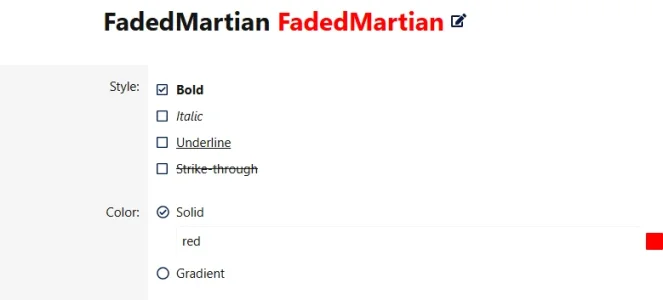

sorry, also, I noticed that while hex and HSL-type values work for colors, typing basic colors like "red" do not work... yet the color picker box to the right of the color field shows the color & in the preview of the style at the top of the style tabs does. is this as intended? is it possible to make basic colors via their words not error out?
the error is as follows when one tries to save the color (when the color word itself is the typed value):
