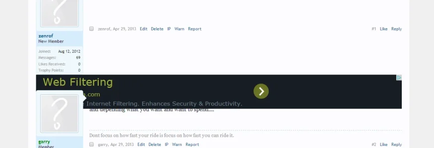

However, it does not seem to work too well on the desktop version of xenforo. When placing the new code into the ad_message_below template and when the actual post is shorter than the right side user block, the .messageList .message height does not increase to allow the banner to fit into that post section and just pushed into the next.
Are you running into the same issue? Is this a google problem or is there an easy fix I can add to my template?

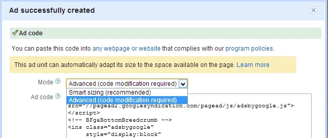

Looks good thanks. I have been using the Responsive ads(Advanced Mode) along with media queries which is working out pretty well. However, just noticed the new code type (Smart sizing) for the responsive design (which is now recommended based on google) and though would give it a try and not have to worry about any additional CSS on my end.
It seems they finally followed through on their promise to make it dynamic.
However, it doesn't seem to work on my site so I wonder if I need to update my ad units.
Yeh.. the update on making it dynamic is awesome but its a bummer for me because I'm not fully finished with customized all my ads using media queries but at the same time cant convert to the new ad code since it does not fully work.

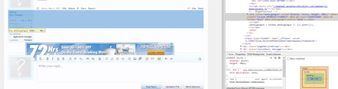

Seems like the adcode is correctly showing under the post because google thinks it has enough room to display it there since the message list element is 960px wide. The problem is that its not counting for the additional elements floating inside (like the user block). Not sure what to do with that...
Update 2:
I was able to encapsulate the google ad code in inline-block and 100% width div tags which seemed to fix the problem:
<div style="width:100%; display: inline-block;">
Ad Code
</div>
So far it looks good but do post if if there are other cleaner solutions.

Just checked and all of my templates are already using the latest code so all I need to do is change the mode for each ad unit :)

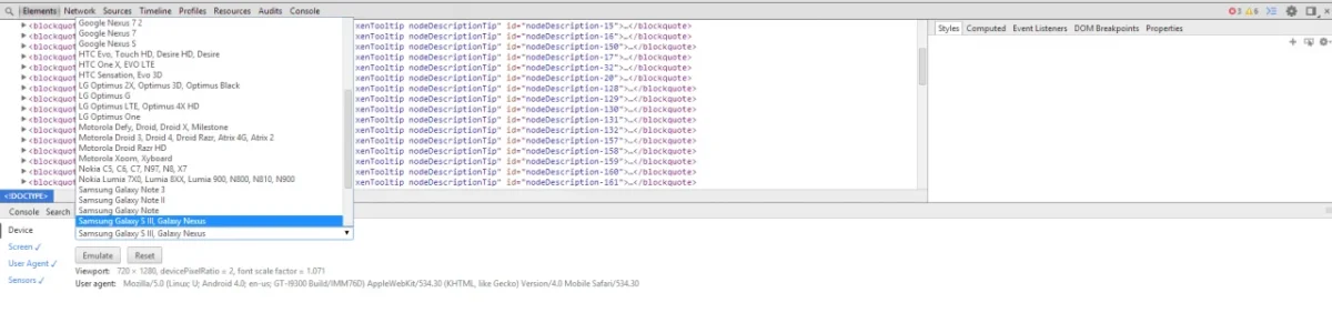

Its no longer working on my specific device but it is working when I emulate using the amazing NEW chrome developer console emulation option!
- First go to Console Settings> Overrides > and check "Show 'Emulation' view in console drawer"
- Open Drawer and select "Emulation" tab
- After you select a device to test with, you can flip between horizontal and vertical view by going to: Screen and clicking on the "Swap Resolution" button in between the horizontal and vertical numbers:
