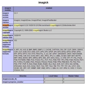

I'm having trouble getting this to work. Here you can see the Imagick extension enabled.
This is a new server so I'm not sure if I am missing something else. The is a VPS from knownhost.com
Isn't that what enables the imagick module in php? I thought having that show in the phpinfo meant it was installed/enabled. :cautious:
The support guys said it was installed.
As far as I can tell everything looks in place. Not sure if this is a problem but this is from the bottom of my php.ini file.

Did you ever get to the bottom of this? I asked my host to install the imagick PECL extension purely so I could have animated avatars, which they kindly did. I went into my ACP and sure enough the "ImageMagick PECL Extension" option was selectable (whereas before it was greyed out), so I selected it and advised my users they could now upload animated GIFs as avatars. A few have tried, however, and none have worked. :(
Is there something else one has to do to make it work?
Thanks.
No I still can't get it working. Idid send in a support ticket here and Mike said he seen no reason why it wasn't working except maybe the version of imagick I am using. Really have had no time to follow up on the issue since though. I will try updating this thread if we figure it out.
Thanks.
Updating ImageMagick to 6.7.1-7 seems to have fixed the issue I was having, previously was on 6.2.8. The imagick version we are on is 3.0.1 anything newer doesn't work with our server.
