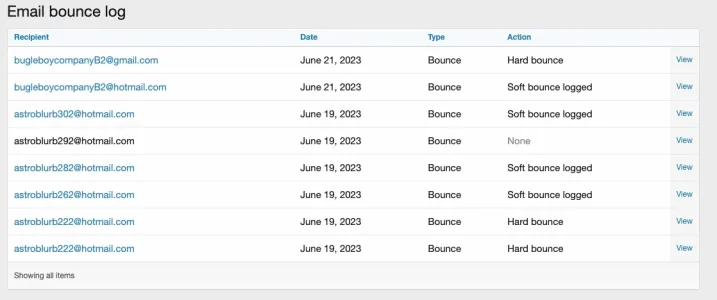

I do not understand your point. Could you please post the bounce log for one hard bounce and one of your softbounces?
Non-Existent hotmail address via valid imap email address which resulted in an immediate hard bounce (and which XF was set to monitor)

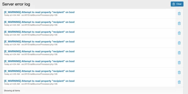

Server error log
ErrorException: [E_WARNING] Attempt to read property "recipient" on bool
src/XF/EmailBounce/Processor.php:106
Generated by: Unknown account
July 4, 2023 at 4:04 AM
Stack trace
#0 src/XF/EmailBounce/Processor.php(106): XF::handlePhpError(2, '[E_WARNING] Att...', '/home/nginx/dom...', 106)
#1 src/addons/Laneros/MailTransport/Api/Controller/SnsNotification.php(45): XF\EmailBounce\Processor->processMessage('{"notificationT...')
#2 src/XF/Mvc/Dispatcher.php(352): Laneros\MailTransport\Api\Controller\SnsNotification->actionPost(Object(XF\Mvc\ParameterBag))
#3 src/XF/Api/Mvc/Dispatcher.php(27): XF\Mvc\Dispatcher->dispatchClass('Laneros\\MailTra...', 'Post', Object(XF\Api\Mvc\RouteMatch), Object(Laneros\MailTransport\Api\Controller\SnsNotification), NULL)
#4 src/XF/Mvc/Dispatcher.php(115): XF\Api\Mvc\Dispatcher->dispatchFromMatch(Object(XF\Api\Mvc\RouteMatch), Object(Laneros\MailTransport\Api\Controller\SnsNotification), NULL)
#5 src/XF/Mvc/Dispatcher.php(57): XF\Mvc\Dispatcher->dispatchLoop(Object(XF\Api\Mvc\RouteMatch))
#6 src/XF/App.php(2487): XF\Mvc\Dispatcher->run()
#7 src/XF.php(524): XF\App->run()
#8 index.php(16): XF::runApp('XF\\Api\\App')
#9 {main}
Request state
array(4) {
  ["url"] => string(22) "/api/amazon-ses/bounce"
  ["referrer"] => bool(false)
  ["_GET"] => array(1) {
    ["/api/amazon-ses/bounce"] => string(0) ""
  ["_POST"] => array(0) {
I'm going to try adding the trailing slash and see if that makes a difference.
For those that say "this works just fine"... well, there is still an error present... it does catch the bounces... but
Server error log
Stack trace
#9 {main}
Request state
array(4) {
These errors appear when you install everything and Amazon tries to connect. After everything is setup correctly with Amazon SES, this error does not happen a second time. Just delete the errors and and see it yourself over the nexts days.

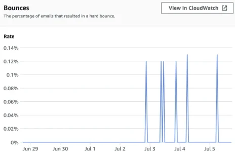

And nary a bounce entry one in my email bounce log other than a few I tested, the majority back in June.
And still have concerns if it's even working....
What do you see in AWS's SES suppression list? IE: https://us-west-1.console.aws.amazon.com/ses/home?region=us-west-1#/suppression-list
Are there new emails being added there? If so, does it seem correct or are there obvious errors?
AWS's SES suppression list logs hard bounces and automatically blocks them. It doesn't log domain errors or soft bounces.
You can export it with the command line interface (CLI): https://docs.aws.amazon.com/ses/lat...l#sending-email-suppression-list-view-entries - outputs in javascript.
aws sesv2 list-suppressed-destinations|clip - requires sudo apt install geomview (200MB)
or file:
aws sesv2 list-suppressed-destinations > filename.txt
or output into pastebin:
cat filename.txt | curl -F 'clbin=<-' https://clbin.com/
Then:
Convert javascript array to CSV: https://www.convertsimple.com/convert-javascript-array-to-csv/ - delete the outmost curly brackets.
Only the ones I ran as tests... and none of those were in July, which the chart shows occurring.
And no soft bounces (which should be listed) in the XF ACP for bounce errors.
The question is, where are all those July bounces coming from... if my site is sending out bounced emails (which is the only thing that uses the SES account) then hard or soft... the XF ACP should be listing them there.... and the ONLY ones it lists are the test accounts that I used when comparing the add-on to using an actual bounced email address setup at another mail provider.
I can see my soft bounces and hard bounces in the bounce log of XF ACP. The amount of bounces in XF is almost 100% the same as at Amazon SES suppression list. You should verify this.
If it does not appear within Xenforo, the user status will not change and this is what you want to have. That is the purpose of this add-on. You do not want to have a kind of "shadow" bounce log within Amazon which does not synchronize with Xenforo.
