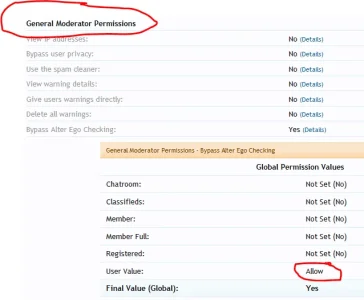

@Liam W - I've tried setting the bypass to 'Allow' for the members I want to white-list but am still getting reports for them.
The permission isn't where I expected to see it though - it's listed under General Moderator Permissions - is that correct (since these members are not moderators)?

Thanks for the quick reply Liam.
Yes, it's set to Allow (but as I mentioned previously, it appears under Moderator permissions - is this what is stopping it working?):
Shouldn't this permission be under General Permissions?

@Clickfinity no, the permissions group doesn't matter (as far as I am aware). I put it there as it is likely to be used for moderators ;)
I'll have a check - it might be that the cookie isn't getting deleted, or the permissions check is ignored if a cookie already exists.
