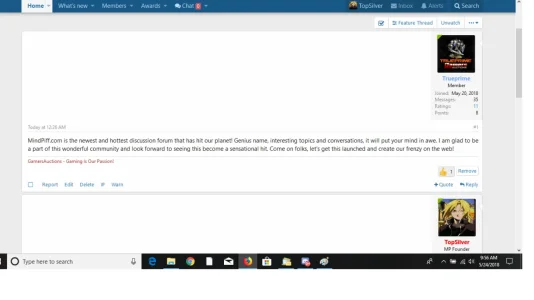

Now I need that part to be above each other and the url space to be wider than it currently allows.
Probably easy fixes but I learn as I go so hopefully someone can help out.
Cheers.
Edit: so like this basically. See how the right side is above each other.

These guys have it also on their forum although they run XF1x but tried to inspect element to see if I saw something useful that would help me solve it but the code looks slightly different.

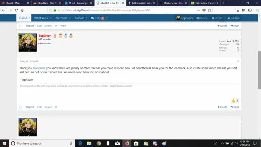

Okay @Cannabis Ape it has been tested in extra.less with 4 different fields shown in the post bit. Considering it's flexbox it should work perfect with the others too. You'll just need to save your code and replace it with what I gave you. I tested it and it works.
I must be missing something because I can't get it to work.
Tried several things before I had to ask you to specify what you exactly what you mean cause i don't want to sound like a total noob but still.
I replaced the .message-inner } with yours but no changes.
Replaced the whole code with yours no changes.
Edit: Now seeing your photo it's completely different of what I mean ;)
Added photo to first post.

Okay I got you just needed to know what you needed. It took me a bit but I got you the perfect code. Now be aware that the important flags aren't needed on every single one but I have a habit of using it often since half the xenforo classes won't work without it. I would use this exact code. I tested it myself and have provided a screenshot below.
CSS:
.message-inner {
flex-direction: column !important;
align-items: flex-end !important;
.message-cell.message-cell--user {
    width: 100% !important;
.message-avatar {
    float: left !important;
.message-userDetails {
.message-userExtras {
    float: right !important;
I didn't position the [bd] medal awards as you don't have that but it wouldn't take much to fix that one too... anyways let me know how that goes.
Yeah you can leave out align-items: flex-end; for this one I forgot to take that out. Essentially making that class a flex-direction: column; does all the heavy lifting, then you just need to float the items correctly. The flexbox part should fix the clutter
