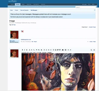

I'm aware that before 1.5.11 the security patch meant that redirected images would not show.
However I just upgraded from 1.5.7 (patched) to 1.5.13 and redirected images are still not showing (only in editor, not on posts)
