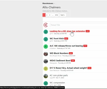

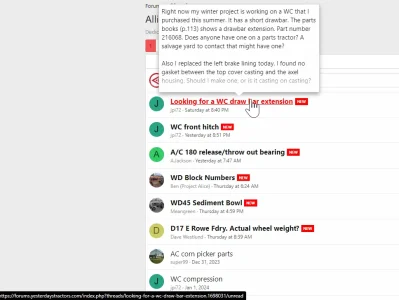

Since then we have noticed the "hover" preview does not work. Here is a screen shot without friendly URL's turned on:
Here is WITH friendly URL's turned on:
As you can see the hover function seems to have been broken by this setting as we have not changed anything else. Is it as simple as needing to rebuild our threads after making the change?

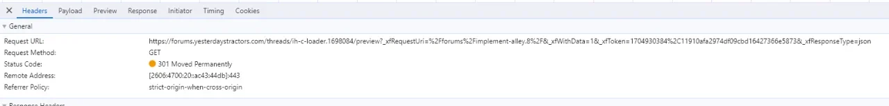

Just to add to what Justin has said, manually entering the URL for the preview fails with the Friendly URL option turned on but returns the expected content when it's off. It really seems like a rewrite issue though I see that this forum is using friendly URLs and the hover works fine. Could it be an anomaly in the RewriteRule just on Apache2. I'm not able to comprehend how the rules provided work as they are so simple, they must be doing more than I understand. Those rules would appear to me to just replace the found Directory, Symbolic link, or File path with index.php. I realize that is not happening on all other URLs since they work fine, but that is what the hover URL returns when the URL option is checked (it returns just the home page rather than the hover content). I wondered if this being an apparent AJAX call, is related.
