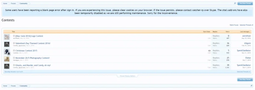

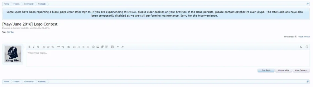

We changed hosts from GoDaddy to Arvixe, and after the migraition some of the posts are not showing. They are ok in the forum list, but when clicking, the post itself is missing.
Someo of the posts are there however. The missing posts seem to be newer ones (posted this month).
Is there a way to get these back?
