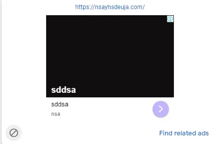

One thing I have noticed is that for the last few months Adsense had been sending us a lot of "Ads" which were just a random string of letters such as "hsdjhsjksdffdu" and invariably linked to websites which didn't exist, or in some case linked to Lorum ipsum wordpress pages.
Obviously we shouldn't ever have had these, but they seem to have died down a lot now, so maybe Google have finally got a hold on them?

No change to our site and no significant changes to stats, but I was aggressively deleting fake ads via the Adsense Blocking Controls (ie. ads which point to non-existent domains/new blog domains and generally had gibberish text in them (See attached for example)
and this month virtually no deduction at all (y)
