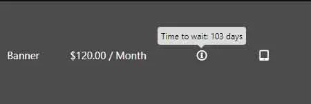

Looks like the tooltip for wait time on packages is using the most recent ad expiration date instead of the oldest.
There is only one expiration date used to calculate time to wait and queued/paused ads are included as well.
yeah I would expect them to be. But I’m saying the days in the tooltip isn’t right. A slot opens in 3 days (the expiration of the oldest ad), and the tooltip is showing the expiration of the most recent ad (103 days to expiry).

To follow up with more info, time to wait tool tip now showing 280 days, when the latest ad expires in 90, and none are in the queue. And now that I think about it, in my earlier post where it showed 103 days, more than the max allowed length (~90 days), with none in the queue.

I've found the issue. Will be fixed in the next release.

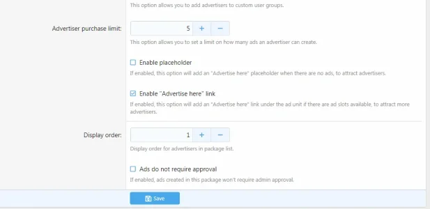

Thanks for answer. I have just changed "Display order". It doesn't affect :(
This value changes only package list order on 1 page "http://localhost/ads-manager/packages/", but not display order of package in the whole board.
Have you changed "Display order" in the package or in the ads? You have to change it in the ads like I have explained it above.
I have figured out. Thanks a lot for you patience. Appreciate you. You was right, I changed value of package, not in the ads.
As a suggestion for future release. Please, connect "Display order" of package with display order on page "http://localhost/ads-manager/packages/" (like now is) and main/global display order (main ads viewing). I think, it should be convenient. Because now "Display order" of package affecting only on that one page. On main page it's sorting by ID (or date or I don't know). It's somehow illogical.
I don't even set display order in the packages because there may be more than one ad using the same package. I just set it in the ads.
Yes, you're right. But if there is more than 1 ad in package, I should change value of each one.
It should be convinient - because now Display order exists, but it effects just advertisers in package list.

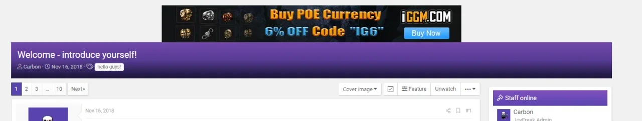

@Siropu There doesn't seem to be margin-bottom or padding-bottom for banner ads. It doesn't look great without spacing like the top of the banner as seen in the screenshot.
