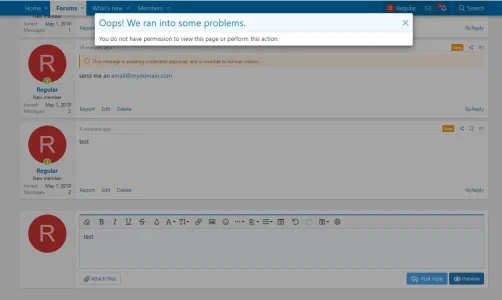

I found a small issue with the usability of plugin for end-users. When a user has reached their limit of posting, if they're on the same page where they posted their last message (the message that makes them reach their limit), the "Post reply" box is still visible. When they try to post the next message, the one that makes them go over their limit, they get the "Oops and error occurred" message.
This isn't really friendly because it makes the forum seem broken and they wonder what they did wrong.
This is specifically noticeable when the post limit is 1; people often post back-to-back messages, so this usability issue will occur often for many users.
I suggest an adjustment whereby the "post reply" text area disappear immediately and be replaced with the default "You can't post here for X days X hours". Exactly as what would happen if the user refreshed the page (a refresh doesn't occur on back-to-back posts.
I believe setting "display:none" for ".js-quickReply" after the limit has been reached, and injecting the default "can't post here for X days" message should resolve the issue.
Screenshot below:
Thank you for the report. The issue is indeed there, but it is a bit hard to dynamically update the screen immediately after posting. What we can do for sure is changing the message on the second post to specifically tell why they can't post another message. If possible we will also force reloading the page after posting if users hit their limit.
That's a crafty and usable work around. The forced reload would be ideal, but using the existing phrase in the warning message would definitely be an improvement over the generic error message.

AddonsLab updated [AddonsLab] Post Limit Per Node with a new update entry:
Redirection after the last post via quick reply form
This version implements a usability fix by redirecting users to the latest post when they make the last post they are allowed based on the current limits. Instead of appearing on the page via AJAX and keeping the quick reply form, the page will now redirect to the latest post and the usual message about the limit will be visible instead of the quick reply form. In case a user reaches the Advanced reply form directly (e.g. via a direct link) they will see the phrase "You have hit the limit on...
