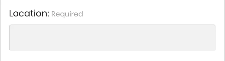

Like this example?
Make it anything you want, here:

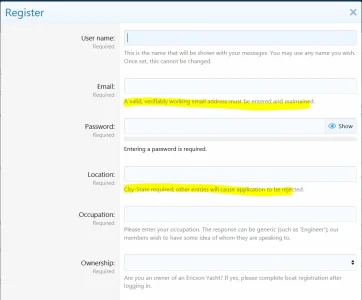

Ah! Beautiful. Thanks so much - very much appreciated!

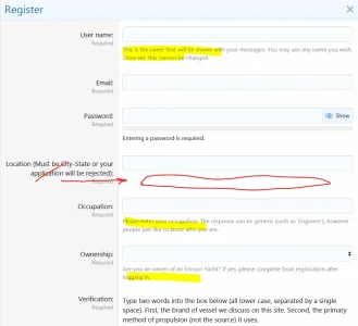

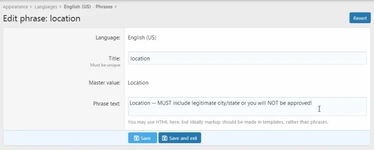

Yeah what I posted above will do that, also that phrase edit will change it for all places that use the "location" phrase so I wouldn't suggest using that after thinking about it for a moment. :p

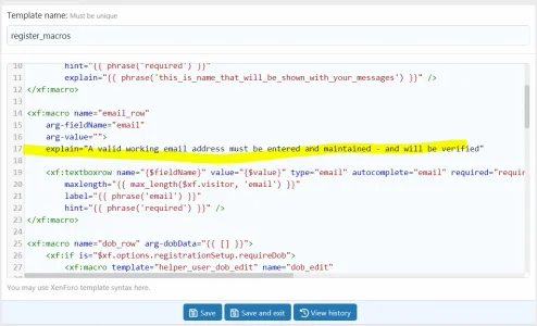

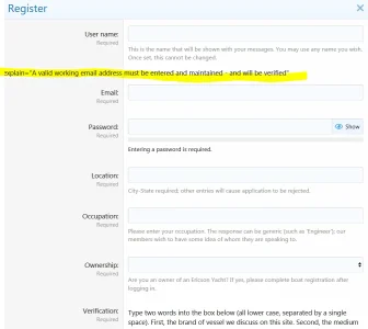

Is that possible to do with the email address also (as I would like to tell them that they have to have a valid email email address, etc)?
There's also this, sorry it's not what you asked thought you might want to take look.
