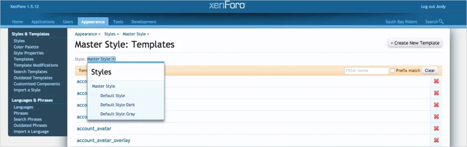

Normally the add-ons install in the Master Style which is hidden unless you invoke debug mode. The Default Style and any other styles you have will inherit from the Master Style.
Well crap, I must have made the default style the master then.
I have the default then the main one I use. So just two styles. I have the default set to user can not choose and it is not set as the default style. The main style is not a child style either. It was imported from VB so maybe it was made the master along with the default during the import.
I suspect you're not understanding what a Master Style is.
Notice the Development tab, you only see that when in debug mode.

You don't. Addons apply to all styles.

OK, so as an admin you can create a style that only you see.
That is easy, you just make it not viewable to users, ie untick allow user selection
But you can still see it, you have a style that only admins can see.
In the Ad Manager permissions, you make it so your admin user group doesn't see the ads.
So when you view that style, you will be seeing it without the ads and can therefore troubleshot.
