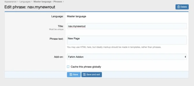

Hi Chris,
I would like to add an icon to the Nav item related to my addon by default.
Under that circumstance, it's fine to edit Master Language, right? I don't see any other option.
Note, this nav.mynewrout variable was automatically created once I defined the route.
