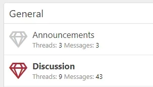

You can use it. Result:

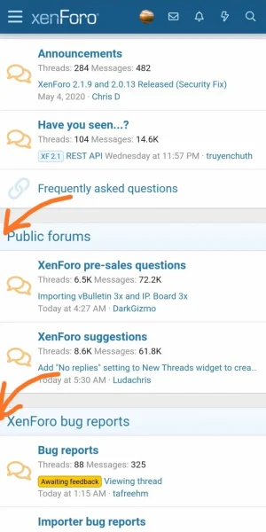

I need to add icons before Categories:
