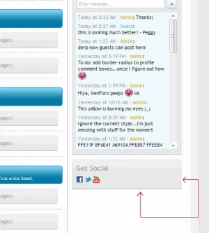

I figured this would be complicated, but it's actually a pretty easy edit to make. :D I didn't already see a guide for this, so:
1. Make a custom template (any title is fine):
<div class="section">
	<div class="secondaryContent">
<h3>TITLE</h3>
TEXT INSIDE
	</div>
</div>
2. Open template PAGE_CONTAINER and find {xen:raw $sidebar}. Just below that (before the closing div tag), add:
<xen:include template="name_of_your_custom_template" />
That should be it! The block will appear at the bottom of the sidebar. If you want it to appear just below the visitor_panel block, but above the Staff/Members Online Now blocks, move the xen:include tag one line up, above {xen:raw $sidebar}. :)
trombones_sideblock-png.7395
To choose an alternate location to place your sidebar block(s), please see this post. :)

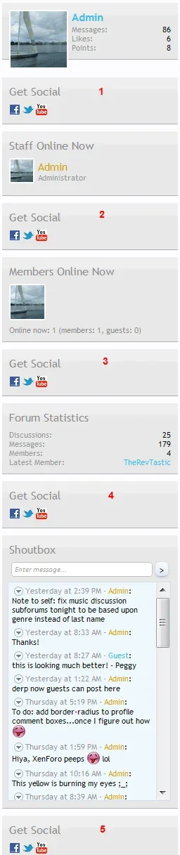

Kurt, what if I want to place the block in another position in the sidebar? Like right below the Members Online box.
How would I do that?
For all of these edits, the text you're putting in will be <xen:include template="kurt_social" />. Just replace kurt_social with the name of your template.
1. Below the Visitor Panel (your name, messages, likes, and points):
Template: forum_list
Add above: <xen:include template="sidebar_online_users" />
2. Below "Staff Online Now:"
Template: sidebar_online_users
Add above: <!-- block: sidebar_online_users -->
3. Below "Members Online Now:"
Add above: <!-- block: forum_stats -->
4. Below "Forum Statistics:"
Add below: <!-- end block: forum_stats -->
5. Below all other sidebar blocks (in this instance, TaigaChat):
Template: PAGE_CONTAINER
Add below: <!-- end block: forum_stats --> and any other <xen:include template lines
