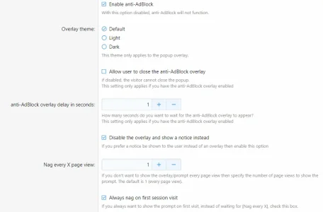

Strange, I just tested and it works, and it obeys the settings. Hmm.
Can you screenshot your settings for me?
Just purchased this add-on.
The default overlay works perfectly but I would like the notice option. That doesn't seem to work.
Do I have to create a custom notice for that? Can't seem to find the adblock options in notices though...
