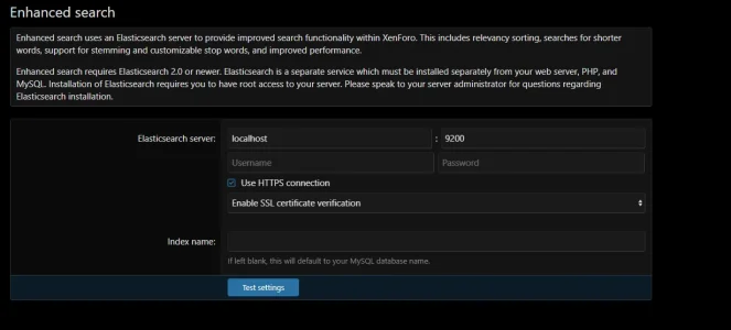

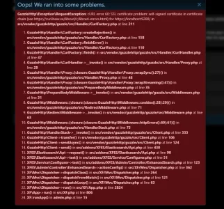

Unfortunately, I keep getting an error when I try that too.Uncheck use HTTPS connection.
nano /etc/elasticsearch/elasticsearch.ymlxpack.security.enabled: false
xxpack.security.http.ssl:
enabled: false
xpack.security.transport.ssl:
enabled: false

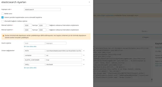

I don't think it creates this directory when installing via Docker, so I'm trying to install it without Docker now, addressing this issue:Do you have the correct security set?
