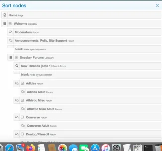

No home is a "page" with site info, then "Welcome" is a category node. The page does not effect the rest. I use the blanks because I use THnodes and I want to fill a section.
