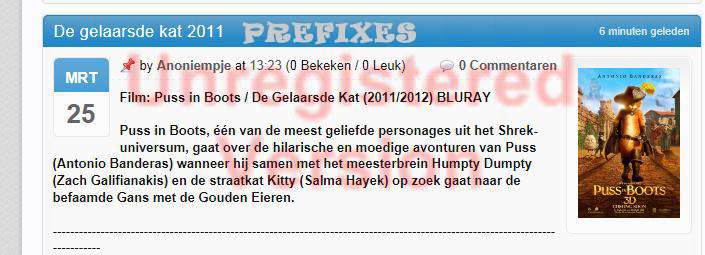

gerard
Hello
it is possible that the prefixes you also can see the blue bar

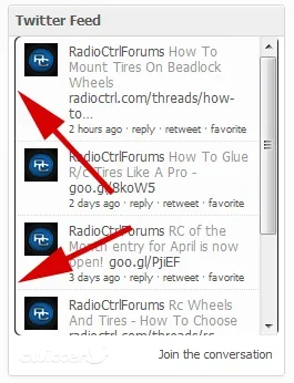

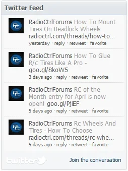

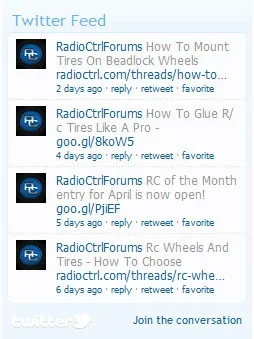

duydangle
Style 1: View attachment 27417 Style 2: View attachment 27418 Default: View attachment 27419
How do I get rid of the black border in Style 1?
I don't know exactly where the problem is, but adding the following lines into EXTRA.CSS of the style can resolve the problem:
.twtr-bd {padding:0px !important;}
.twtr-timeline {border-radius:0px !important; -moz-border-radius: 0px !important; -webkit-border-radius: 0x !important;}
Actually I don't find anywhere to set the border's properties... You can have some professions resolve it for you
Archet
Awesome, that did the trick! Thank you!
