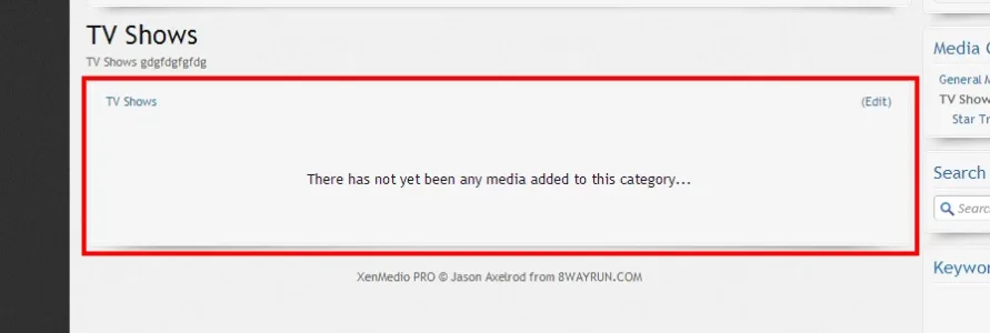

I was wondering if there is any way that when I select a parent category, that it will show the contents inside the child/sibling categories? Because now when I create a category with two child category, selecting the parent results in a empty page.

@Jaxel, with all due respect your XenMedio threads are scattered around here like grass seed. I did search for "categories" and "xenmedio" here but did not find where you had said that.
When a xenMedio category is empty, it should display child categories contained within the parent and not just "THERE'S NOTHING HERE". That looks bad and is poor UX.
If I go to an empty forum, the sub-forums are displayed in the main content area, just as xenMedio should do.
If you're that opposed to changing it, how would you suggest I achieve the following without the drawbacks that currently exist? http://xenforo.com/community/threads/8wayrun-com-xenmedio-media-pro-paid.48638/page-4#post-596117
Thanks.
And as I've said before, this will NEVER be put in. Thats just not how categories work, even in the rest of XenForo.
If you go to an empty forum, it doesn't list all the threads contained in the subforums does it? Of course it doesnt.
How would I hide the area highlighted in red on a per-category basis? One could use the category description to put thumbnails of all the children categories and achieve a middle-ground result.
I figured out a workable solution; you can edit your templates to exclude or include elements using the following:
PHP:
<xen:if is="{$category.category_id} != X">some stuff</xen:if>
Replace X with the category ID; I ended up placing the opening logic before the div where the media would be displayed and placed the closing logic afterwards. This way only the category description is visible.
