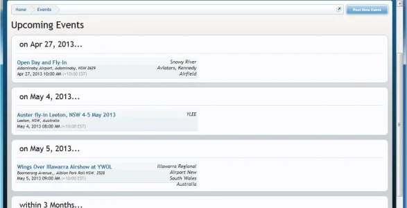

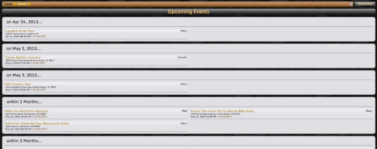

I seem to be having an issue with v1.5.0...The upcoming events I have set to 21 days in the options yet the events forum isn't showing the events for the next 21 days, just the first one...Today is the 23rd April so I should be seeing the events for the 4th and 5th May...see attachments:
Any ideas what could be wrong Jaxel?
Most likely it is something in your system. As you can see, on mine it is working fine. Only possible difference would be that I am using XenAtendo More by Waindigo.
I agree, it's likely to be something on ibaker's system as it is working fine on my site (I'm not using XenAtendo More by Waindigo).

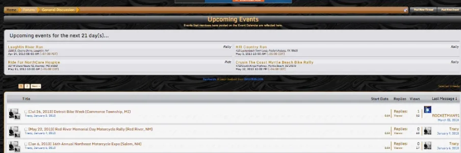

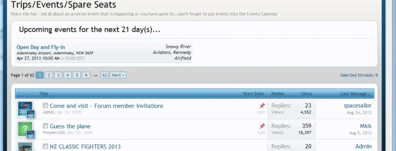

View attachment 45068 View attachment 45069

Found the problem...it only displays the event as an upcoming event at the top of the forum if you select to create a thread for the event...if you don't then it doesn't get displayed.
I created a test event and selected "YES" to create a thread and it did display it in the upcoming events at the top of the forum. I then created the same event but this time I didn't create a thread and it wasn't displayed at the top of the forum.
Can anyone else confirm this?
Yep, and that makes sense as if it pulls the information directly from the forum and not from the event list database. I would have thought though it pulled directly from the event database.
Thanks Guys!
So users don't really know all the upcoming events then...sort of makes the display across the top of the forum pointless unless it contains all the upcoming events like the Portal Upcoming Events does and the same as what is displayed in the XenAtendo Upcoming Events List...It is pulling the info from the `EWRatendo_events` table so I think it is using a query with an incorrect "where" clause for its purpose as in "where thread_id > 0"
This would have to be a bug then wouldn't it? Any ideas how to fix this?
Yes and No. To me, it makes sense if you want to see all upcoming events to use the actual Events menu option at the top and look at upcoming events. It does appear to be a buglet tho' as I would assume it would pull all events.
This is by design... if you had multiple event forums... why would you want the upcoming events block to show events that do not belong to that event forum... doesn't make sense.
