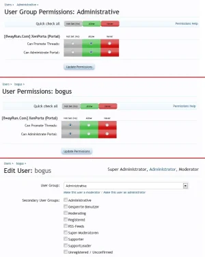

Here is a Screenshot of my User- and Adminrights

thx for the above, very helpful.
So you see the Modules link on the sub-navigation bar, but when you select it nothing happens and you remain on the home page. This happens in the default style.

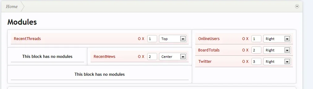

Is there anyway to fix this problem? Instead of the left module space being to the left, it is with the center / top modules, as you can see with the attached image.
