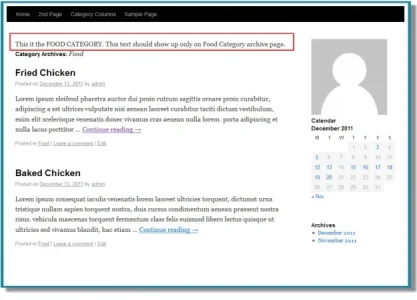

This looks great, wow you are a very talented coder and have pretty much made Xenforo into a functioning CMS. It would be helpful to be able to have a category header at the top (above the article snipets) and be able to have a category description. That way people will know they are viewing category archives. When you first click on the click it isn't readily apparent what exactly you are viewing. Or even something as simple as a header that says; "Category Archives: Hate Speech". I found this example (Wordpress) below. The red box is a category description and could be above or below the title header.
