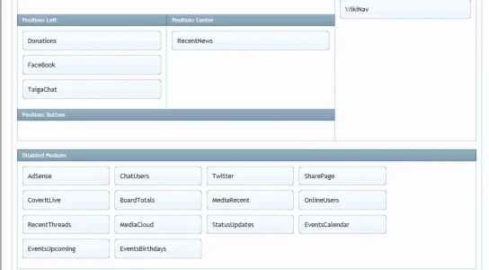

Hi there. i have installed the newest version but where can i edit the Modules?
Before this update i could click onto the modules name, e.g. RecentNews, but that is not possible anymore. Permissions are all set to allow
You are most likely using the wrong link to access the modules.
As an admin do not use "Customize This Page". Instead use "Modules".

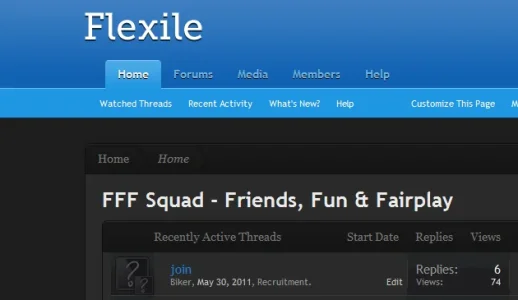

Edit, nevermind. I seem to have two home buttons now, any idea how I get rid of one of them? Cheers.

With relation to my previous post here's a snip to show you what I mean about the two homes. (There was previously two homes in the blue nav bar too but I edited navigation file to remove it before I realised it was a bigger issue)
Revert the edits you did to the navigation template.
Go to your ACP > Basic Board Information > Home Page URL and delete whatever info you have in that box.
