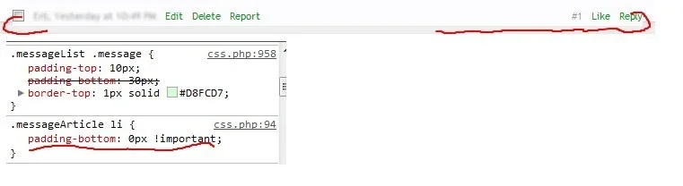

Why did you remove the padding here?
I fixed it with this code in the EXTRA.CSS:
.messageArticle .message {
padding-bottom:8px !important;

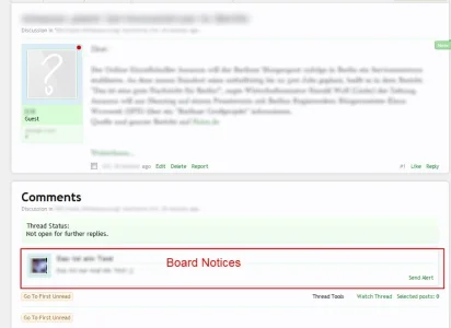

I noticed the same thing but it's the [xfr] Board Notices add-on so maybe the change needs to be made in that, rather than in Jaxel's portal?
