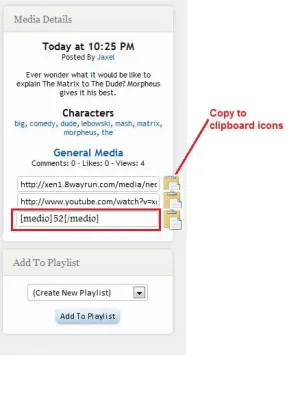

Would it be possible to have a "Copy Medio to Clipboard" link - so I could easily copy and paste the media library item where I want ?
This would help out more people ... whom
(1) aren't aware enough about URLs to know that http://xen1.8wayrun.com/media/neo-lebowski.53/ is actually media item 53.
(2) even if they know to remember 53, they might not still remember.
(3) forum people are lazy, better make it easy for them.
