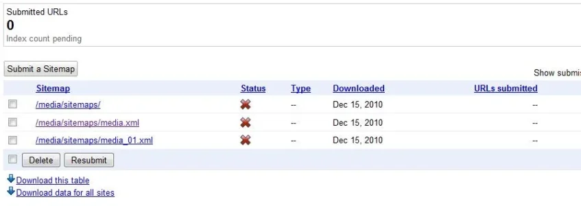

I have this error, over and over again in my error log files,
fopen(/nfs/c07/h02/mnt/110115/domains/mysite.com/html/data/sitemaps/media_01.xml) [<a href='function.fopen'>function.fopen</a>]: failed to open stream: No such file or directory library/EWRmedio/Model/Sitemaps.php:56
Well, Jaxel helped me out with attempting to fix the issue and we can't figure it out. (Thanks for the attempted help, Jaxel)
But, we're still getting the following message...
And, while testing we had turned off the URL-friendly option and we still got this...
Jaxel suggested going to our hosting company for assistance. Any other suggestions that may help? :confused:
Just wanted to say I figured out the errors we were having over at teeveetown, the problem was caused by an extremely tight security module. Once again thanks to Jaxel for his original attempt to help us, and we are now happy we have our media section working. :D

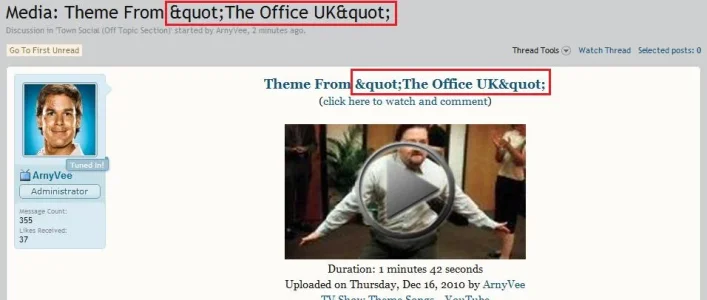

Jaxel, noticed that when creating a new thread and the title of the video has quotes, that we don't have quotes upon creation. :)
