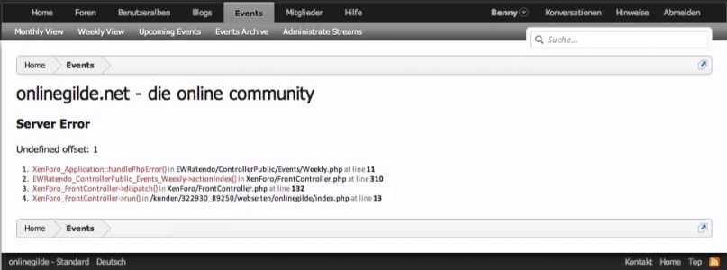

Hi I have a little Problem, maybe someone knows the answer
Everything works fine except of one thing. When I am in monthly view and click on a date in the calendar the following message occurs:
When I click on Weekly View from the menu bar it works. Maybe someone knows what is going wrong
