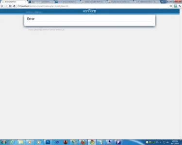

So there's a '304' error when trying to grab the 'ajaxload.info_FFFFFF_facebook.gif' followed by the '500' errors.
Thing is, there are no PHP errors. Even when I refresh where it fails:
http://localhost/xenforo/install/index.php?install/step/2b
All I see is this:

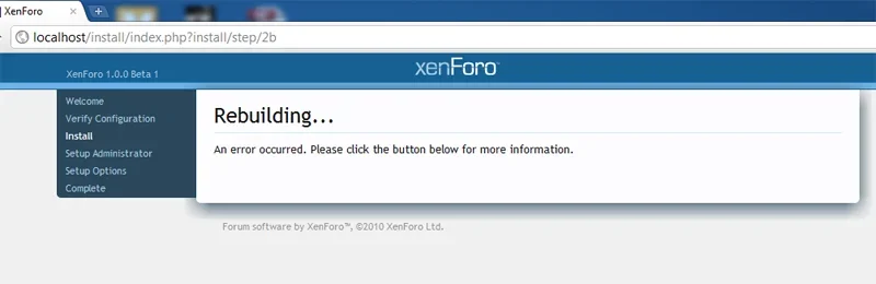

Here's where the install script is aborting:
Some how I have a strange feeling IIS doesn't like this query string:
Since mod rewrite isn't active, how is it really interpreting this? Should the query string read something like this:
index.php?install=step-2b

Scratch that. I see the steps 1, 1b and 2 successfully complete so it's not a URL problem.
I have reinstalled in c:/zend and everything is exactly like it was before. I think PHP is indeed bombing out and is why no entry in the error log is posted. The PHP error log is still showing no entries for this specific error but the IIS log is still getting '500' errors for step 2b. Here's the log:
