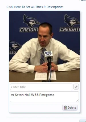

Here here! Very inconvenient that youtube url's with a list tag get no thumbnail. At least 50% of the youtube media uploads we get have a list tag (and no thumbnail) :(
