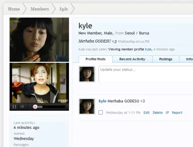

I was unable to get it to work. I was able to get the additional field on the profile, however the video does not appear.
This link shows where I placed the code.
This link shows where the video should be displayed.
This link shows the new field in the profile with the YouTube video code.
Anyone see if I'm doing anything wrong?
Thanks
Sorry, that was weird. I fixed the link but can also show it Here. I applied the same code to the "default" and "Flexile Dark Standalone" styles.

Hey, you led me in the right direction. Note to self: "Ensure the field name you create for your profile "youtube" is accurately reflected in the two referenced places in the code. This is case sensitive!
Now, I just need to figure out what to do when I get the message "Video Player is too small".

Based upon some google searching, it seems that YouTube is implementing a minimum height and width requirement to facilitate their ads. I read that 230 x 230 is the minimum required. On my sight, this work and makes it so the video plays, however it pushes the video into other things since I am using a fixed width. I will probably have to change the fixed width so that it works correctly. Here is currently the way it looks.
