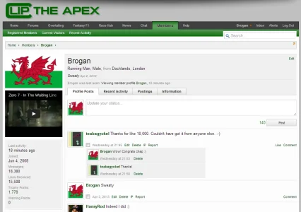

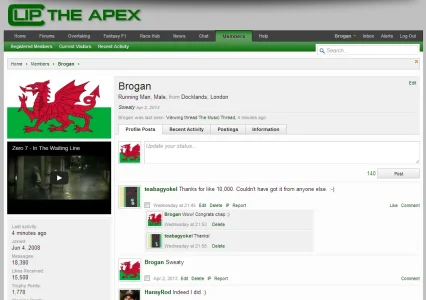

Based upon some google searching, it seems that YouTube is implementing a minimum height and width requirement to facilitate their ads. I read that 230 x 230 is the minimum required. On my sight, this work and makes it so the video plays, however it pushes the video into other things since I am using a fixed width. I will probably have to change the fixed width so that it works correctly. Here is currently the way it looks.
I have added this to EXTRA.css to increase the size of the left sidebar:
.profilePage .mast {
width: 246px !important;
.profilePage .main {
margin-left: 254px !important;
.profilePage .avatarScaler img {
max-width: 246px;
I then changed the YouTube embed code to match:
<xen:hook name="ad_member_view_below_avatar" />
<xen:if is="{$user.customFields.profile_youtube}">
    <div style="margin-top: 4px; margin-bottom: -5px;">
        <iframe width="246" height="172" src="http://www.youtube.com/embed/{$user.customFields.profile_youtube}?wmode=opaque" frameborder="0" allowfullscreen></iframe>
    </div>
</xen:if>
Before:
After:

You just need to reduce the .profilePage .main margin-left: 254px it looks like.
I discovered an issue with the above approach.
To resolve it, just add this to EXTRA.css:
max-width: 246px;
Then change the profile page sidebar width in Style Properties -> Member Profile Page -> Sidebar Width: 246px
I have chosen 246px as it enables four avatars to be displayed on a single row for the Following and Followers blocks. You may need to adjust the dimensions to suit your style.
The other thing you will need to do is edit the /library/XenForo/ControllerPublic/Member.php file to change $followUser to 6.
