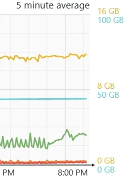

Already looks much better on the charts for CPU with about 70k new IP's already compared to the previous version and wiping the table for it to be minimal. CPU has significantly smoothed out processing in handling IP tables now. Thank you.
