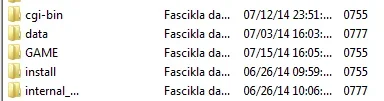

What does it mean to CHMOD777 the sitemap folder? Can anyone help me? I'm new to this but would really like to work with this add-on.
