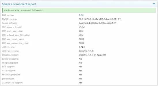

Can you check your server errors logs in order to know what's wrong ?
I think you have limitation in your php configuration

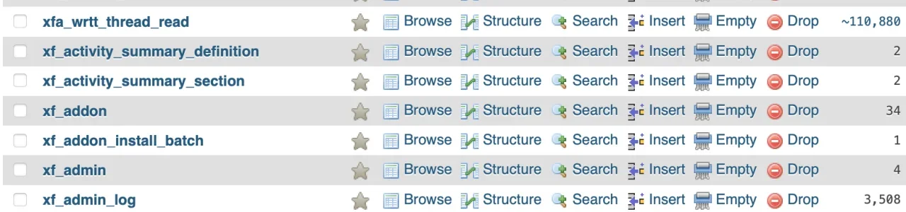

BTW, after update the table still is xfa
The upgrade code is missing in setup.php
You can manually rename the table xfa_wrtt_thread_read to xf_xfa_wrtt_thread_read to solve this.
