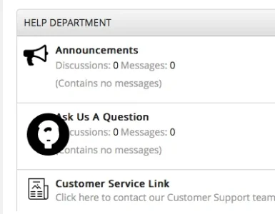

Also why would one icon display correctly, but another display too big? Both are set for the same 36px.

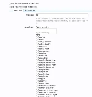

But it's official, no way to select color, and icon preview does not work. See below.

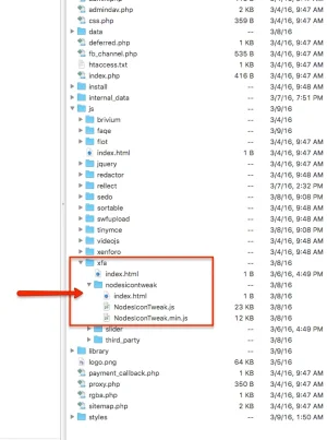

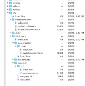

For both issues, I can infer from the screenshot that you didn't upload the js files to your server.
Clément
This screenshot says you're wrong. So what else could be it be?
