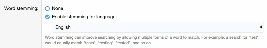

You should upgrade to Enhanced search because the default search is very slow when you have more than 500,000 posts. Also the Enhanced search uses stemming which provides better results.
No clue where you got the number from, but that's not something you can generalize. Besides that, stemming has a lot of disadventages, especially when you don't have an english speaking community or your community uses mixed languages or your community can't use their language properly. Stemming actually is only useful in scientific / journalistic fields.
