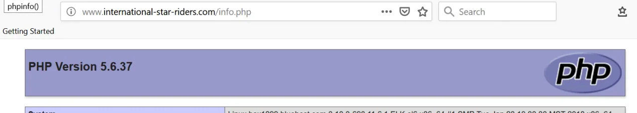

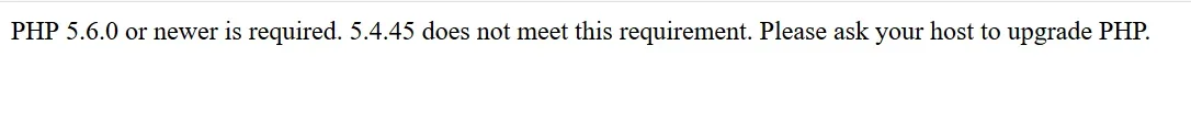

Whilst your home page is running PHP Version 5.6.37, your forums are actually running on 5.4.45. Visit your forums home page and add info.php onto the URL to see this (which I've just done to check).

You have something on the server that is conditionally overriding the PHP version used specifically in certain directories:
Haven't we had a similar situation before?
Issue that @Mr Lucky had on one of my servers, as the there were multiple .htaccess and cPanel inserts the PHP handler code into there, so different directories for the same domain can run different PHP versions.
Here:
In my case the confusion was because I had installed a test forum in a sub directory, copied all the main forum files across including .htaccess. So when I upgraded the php on server to 7.2. it did in fact upgrade (and changed the root .htaccess) , but because the .htaccess in the subdirectory still referred to 5.6, then there was a message in the test from saying it was on 5.6, (but was in fact on 7.2)
