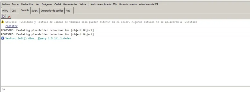

You don't have any JS error... because you don't have any JS ^^ Must be a problem with the version of your addon. Download it again. Uninstall it - reinstall it.

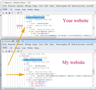

The problem is that the template captcha_qaptcha doesn't seem to load...
Template is loaded, but the <script> does not load from it.
Tize, find template captcha_qaptcha your forum style in the admin panel and post here the contents of the template.

captcha_qaptcha =
PHP:
<xen:require js="js/qaptcha/jquery-ui.js" />
<xen:require js="js/qaptcha/jquery.ui.touch.js" />
<xen:require js="js/qaptcha/qaptcha.js" />
<xen:require css="qaptcha.css" />
<script type='text/javascript'>
    function refreshQapTcha()
        jQuery('.QapTcha').empty().QapTcha({
            txtLock : '{xen:phrase qaptcha_lock}',
            txtUnlock : '{xen:phrase qaptcha_unlock}'
    jQuery(document).ready(function() {
        jQuery('.QapTcha').QapTcha({
</script>
<div class="QapTcha jsOnly">{xen:phrase loading}...</div><noscript>{$noscript_code_notice}</noscript>
HTML:
</script>
