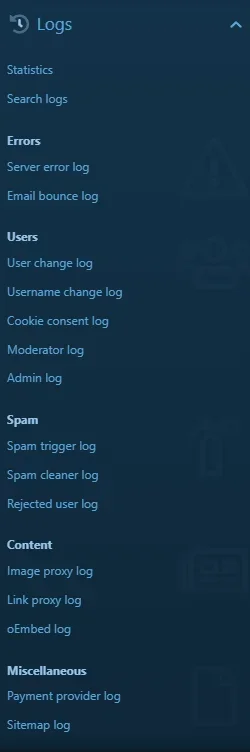

Sorry, I'm a little thick. Where are the logs shown in the admin panel?

Thanks for the detailed follow-up - yes, that pattern does sound consistent with a Layer 7 / HTTP flood style event, especially if the traffic is arriving in waves rather than as a steady continuous stream. I wouldn’t want to say with certainty that AI is driving the behaviour without seeing the raw request patterns, but rotating IPs, residential proxies, challenge/back-off cycles, and pulsed bursts are all very plausible in this sort of scenario.
