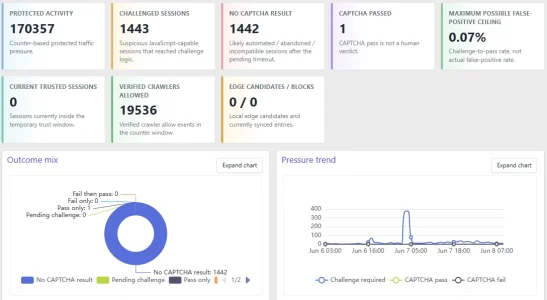

Great new feature! Even with close to 17000 bots on my system, it's holding its own.

1.2.3 has been running great for over a day with the above setting changes. Zero-signal IP data I set to the minimum allowed 720 rather than the 24 mentioned above but all seems fine. I just installed 1.2.5 and no issues so far. Thanks again!

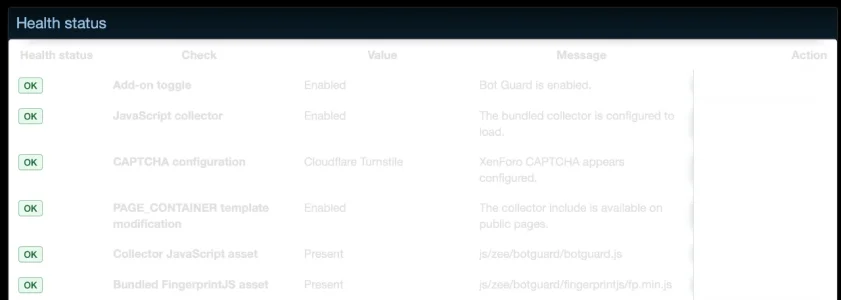

Just installed this to test it out. Some pages are hardly readable:
Still settings things up, will let you know how it goed @zeeb0t
That helps a lot, thanks :) Still, could be styled better...

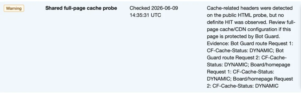

Another question, not sure how to solve this:
Tried disabling Redis caching but that didn't help. Nginx caching maybe?
Its just a warning that it detected some cache headers but not the ones it is truly worried about.
It says this incase there was some kind of cache hit header I don't know about... but found artifacts that MIGHT be an incidacator of page cache, hence the warning. Its basically asking you to confirm.
But in your instance, its clearly Cloudflare - so just ignore that message. I will tighten up the logic.
