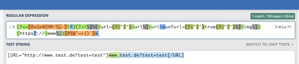

This is the current value of $autoLinkRegex in my copy of the files:
PHP:
$autoLinkRegex = '(?<=[^a-z0-9@/\.-]|^)(?<!\]\(|url=(?:"|\')|url\]|url\sunfurl=(?:"|\')true(?:"|\')\]|img\])(https?://|www\.)[^\s"<>{}`]+';
The issue can be confirmed on https://regex101.com:
197520

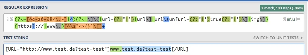

However, if I update the regex to this:
PHP:
$autoLinkRegex = '(?<=[^a-z0-9@/\.-]|^)(?<!\]\(|url=(?:"|\')|url\]|url\sunfurl=(?:"|\')true(?:"|\')\]|img\])(https?://|www\.)[^\s"<>{}`\[]+';
(Important part: \[ before the ]+ bit at the end)
The regex works on the website:
197521
Producing this output:
String before autoLink: www.test.de?test=test
String after unfurlLinkRegex: [URL="http://www.test.de?test=test"]www.test.de?test=test[/URL]
Parameter passed to autoLinkUrl: www.test.de?test=test
String after autoLinkRegex: [URL="http://www.test.de?test=test"][URL="http://www.test.de?test=test"]www.test.de?test=test[/URL][/URL]
