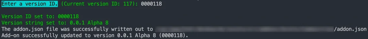

As designed xf-addon:bump-version requires zerofill to parse version IDs below 1.0.0

If anything, there is a bug here which is that we shouldn't allow version IDs to be specified that are prefixed with zero. 0000118 is not a valid integer and we expect it to be for version comparisons.
With that in mind, you'll need to continue specifying the version ID as 118 and accept that you'll have to write the version string out manually to mean what you want.

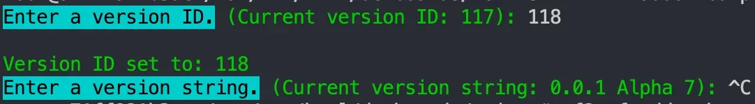

Fair enough, 99% of cases I wouldn't expect using 0.0.1 as a starting version, but this is a project that needs to be deployed frequently to a test site and I'd like to use the standard upgrade step procedure rather than manually altering the database / SSHing in to run update commands 😅

If you're starting with version 1.0.0 Alpha what's stopping you from using the standard upgrade step procedure? There is a limiting factor I suppose in that a version ID suffix from 10 to 29 are the only valid "Alpha" versions so I suppose if you're planning to have more upgrade versions than that then I see your point.

Yeah I think we're ok. I hadn't actually tested it yet but it seemed to me like it might be possible that it was generating and saving a version ID of 0000118 which would be invalid.
