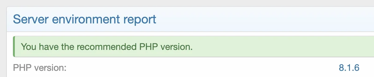

Great to see XF 229 released just now, looking forward to installing it. Just a quick clarification please.
I see that compatibility with PHP 8.1 has been improved in several areas, but is it now recommended to use it on a production system?
It seems to me it still isn't, especially as the system requirements page shows as below. I want to use the highest version of PHP that's recommended.
