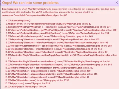

Has anyone using 8.1 with 2.2.9 noticed an error with PUSH notifications? (when someone LIKEd a post) This was my only issue.
I set it back to PHP 7.4 for now.
I don't see an option for gmp in the multi php editor, or the php.ini.
I hae no idea whhat a "multi PHP editor" would be, but GMP is available on PHP 8.1 - we've got that enabled on our servers (using Debian/Ubuntu, no control panel involved).
Perhaps I should check with my host, to see if it is something they have to enable. I'm fairly limited, by Cpanel.
Thanks
