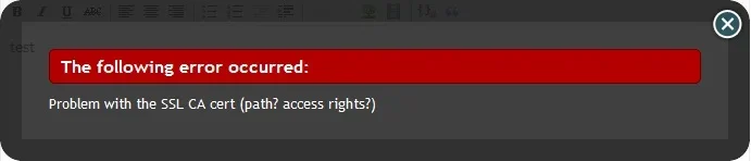

umm... does this still happen when you disable Facebook?Thanks but it's still not workingerror screen shot attached...

Sorry to bother you so much but still the same cert path erroryes, something like that...
and no, the access token will be retrieved only once... but the expiry date of the token will be extended every 30 days... added a cron job entry for that![]()
the ssl cert is fine... try chmod'ing the ca_bundle file to 777, which you find in: rootdir/library/xenCODE/Socialize/HelperSorry to bother you so much but still the same cert path error![]()
Tried but doesn't help...the ssl cert is fine... try chmod'ing the ca_bundle file to 777, which you find in: rootdir/library/xenCODE/Socialize/Helper
check this out: http://martinsikora.com/facebook-php-api-without-curl-extensionTried but doesn't help...
