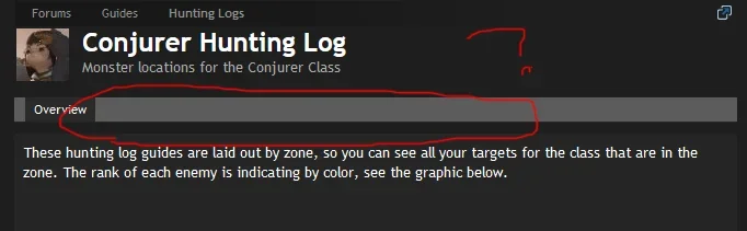

So I'm having a bit of an issue finding out what is wrong with my resource manager. I'm using version 1.0.2 and XF version 1.2. None of my guides can be rated or reviewed, I'm missing tabs that exist once you're inside the actual guide (similar to the RM on this site).
I've looked on the site and googled, and couldn't find any documentation. That or it is really well hidden. Is there something obvious I'm missing? All permissions are set accordingly. Resources were renamed to Guides fyi.
Thanks for the help.
This image shows where expected tabs would be.

I have just reviewed your resource. Which means this page should work: http://forums.ffxivhorizon.com/resources/conjurer-hunting-log.10/reviews
But I get redirected back to the resource page. That would only happen if no reviews are found, yet clearly there is one.
This is what makes me think either add-ons or some code changes you guys have made are causing it.
