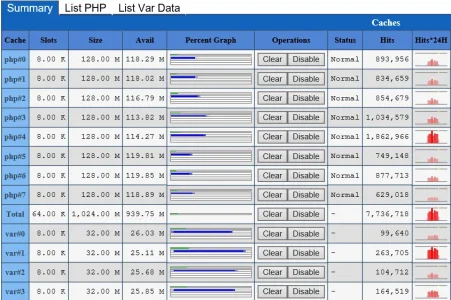

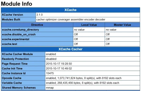

My board is not able to support more than 50 concurrent users (google analytics). I am on a dedicated server with below config
Is there any out of the box configuration that needs to be done?
